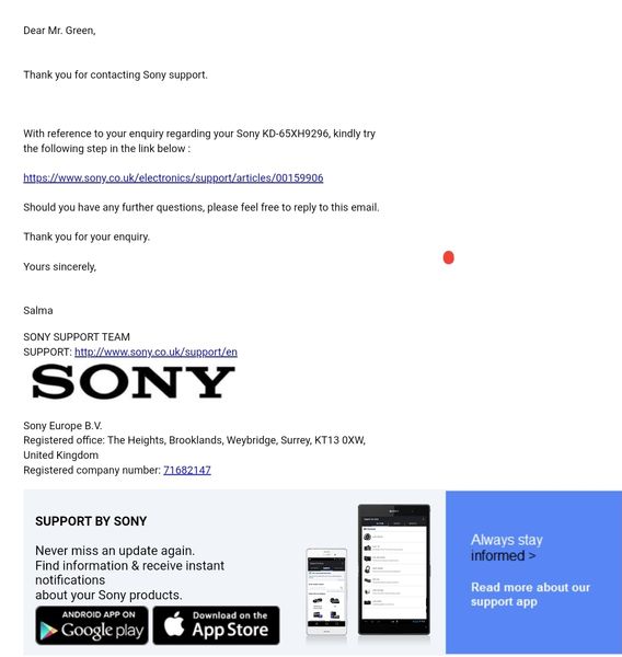

GreenySCFC
Member
This is them sending me the original link for the forced factory. in truth tho i don't know what the difference is but they first told me to do an ordinary factory and I said that I'd donte that already 3 times. At the time my original issue was the TV random switching off and back on again. It took about 2-3 weeks of emails back and forth before I got the forced factory link. It might be just down to the knowledge of the agent thats dealing with your issue to why they haven't said to u about the forced factory yet.
GreenySCFC
Member
It did for me so it might do for you.

GreenySCFC
Member
Yesterday for the crackle/popping of the speakers and the lip sync. The TV switching off and on was about a month or more since I did the forced factory reset. So since doing either I've had no issues, Like I said it worked for me, it might work for you. I was just letting you know and anyone else who's having issues what worked for me it may or may not work for you.
