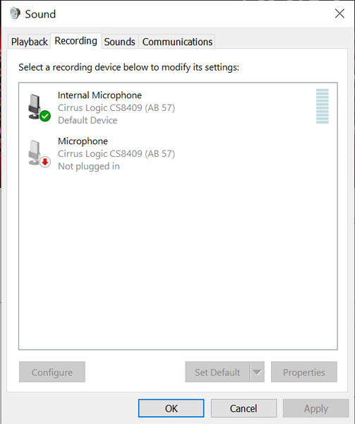

When I connect my WH-1000XM4 on Windows 10 via bluetooth I get the following (see screenshots).
There is no option in the "Sound" window to select the microphone as a audio input device.

As you'll see the issue is that I only see one output audio device (not the two in the screenshot) and no input audio devices.

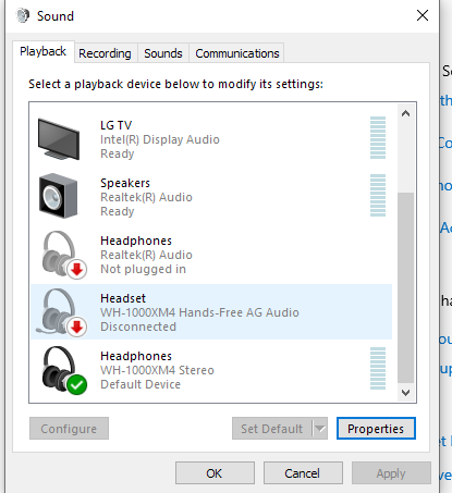

Did you manage to resolve this issue? I have the same problem. It only happens on my work Windows 10 laptop my personal laptop does have XM4 as an input device.
The Headset connection for the XM4s is visible in the sounds settings but not connected:

I had the same issue and it was driving me nuts. I found this feed after a search which didn't help but eventually I found the right setting to get it to work. Try going into the "Control Panel" and select "Devices and Printers". Right click on the WH-1000XM4 and select "Properties". In the "Services" tab, check the box next to "Handsfree Telephony". After I got that selected, my microphone worked fine. One odd thing, though, is that I tried to disable it and re-enable it but it gave me an error when re-enabling. I had to reboot before enabling again.
